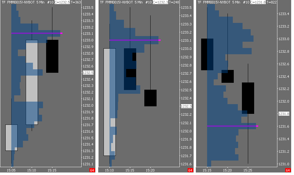

[2015-05-09 21:04:22]
You can do what you want. Here is a screenshot of the chart and of the Tool Values window which shows the relevant Input settings of the Volume by Price study configured the way you need:
http://www.sierrachart.com/image.php?l=1431205390298.png
You can programmatically access the point of control using the point of control Subgraph, sc.Subgraph[1], from the Volume by Price study.

SgtJ - Posts: 154
Re sliding window, it seems the only way to do it is as mentioned above re using the visible bars option in "volume graph period type".
Set your chart window to the number of current bars you want to see...in this case I chose 3.
